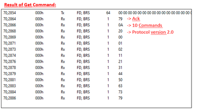

My anwser of get Command.
I hope this helps.

I have finally achieved success.
# configure the CANFD driver on Linux:
sudo ip link set can0 up type can bitrate 250000 sample-point 0.75 sjw 16 dbitrate 1000000 dsample-point 0.75 dsjw 4 fd on
# monitor the CAN bus (in a different window/tab):
candump -tdex can0
# send a standard (11-bit) CANFD frame with BRS set, ID=000 and a 64-byte payload:
cansend can0 000##100000000000000000000000000000000000000000000000000000000000000000000000000000000000000000000000000000000000000000000000000000000
# it is important to note in the command above the double-hash (##) which tells cansend that this
# will be a CANFD packet, and then the single '1' before the 64-byte payload which sets the Bit
# Rate Switch (BRS) switch in the outgoing packet.
# observe the CAN traffic in the candump window:
(179.707038) can0 000 [64] 00 00 00 00 00 00 00 00 00 00 00 00 00 00 00 00 00 00 00 00 00 00 00 00 00 00 00 00 00 00 00 00 00 00 00 00 00 00 00 00 00 00 00 00 00 00 00 00 00 00 00 00 00 00 00 00 00 00 00 00 00 00 00 00
(000.001531) can0 000 [01] 79
(000.000025) can0 000 [01] 0B
(000.000009) can0 000 [01] 11
(000.000009) can0 000 [01] 00
(000.000007) can0 000 [01] 01
(000.000008) can0 000 [01] 02
(000.000008) can0 000 [01] 11
(000.000008) can0 000 [01] 21
(000.000008) can0 000 [01] 31
(000.000999) can0 000 [01] 44
(000.000012) can0 000 [01] 63
(000.000006) can0 000 [01] 73
(000.000005) can0 000 [01] 82
(000.000006) can0 000 [01] 92
(000.000006) can0 000 [01] 79
I can issue various commands, including the ID=0 but with no payload at all and get the expected response.
