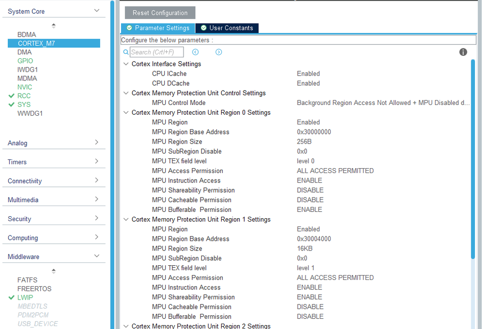

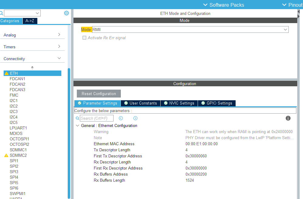

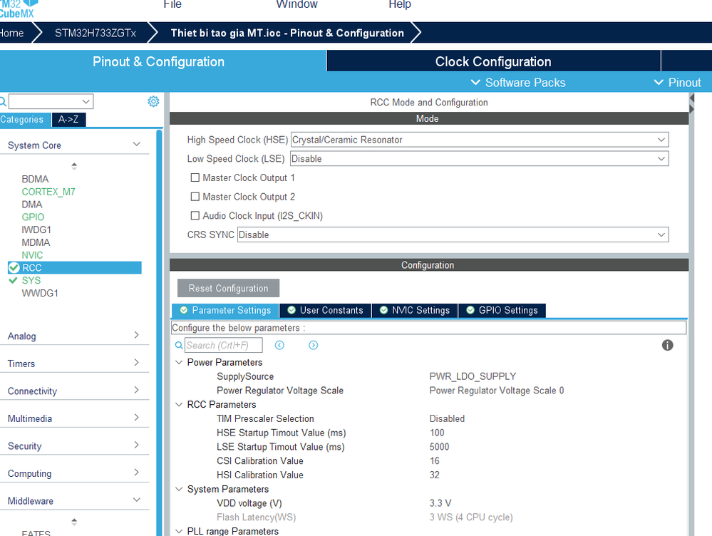

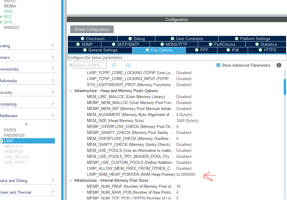

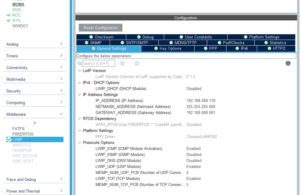

Can anyone know how to config ?
this is my .IOC file
