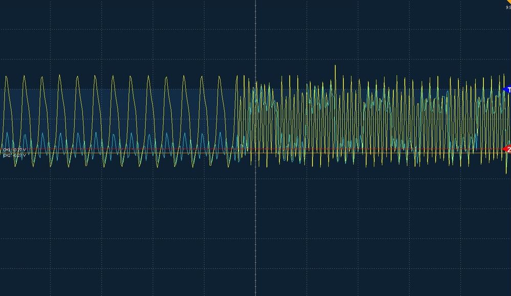

So I have finally fixed the problem, my reluctancy to acknowledged using the HSI could be the problem has been my downfall.
I have tried adding 24.576 MHz to is2_ckin, and now everything is stable...
A lot of thanks to every one who has applied to the thread.

So here are my newest measurements, LRCLK (BLUE) and BCLK (YELLOW). The problem isn't jitter, but that LRCLK changes more often than every 32 BCLK, but only a few times per second.
I am using the HSI, but as i have just added, it isn't jitter.
