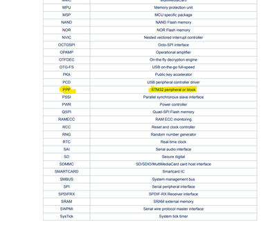

Hello @AMacd.1
This acronym 'PPP' is described in the UM1884 at the page 5.

Hello @AMacd.1
IN UM1884, the terms HAL_PPP, hal_ppp, and similar references (e.g., stm32l4xx_hal_ppp.c, HAL_PPP_STATE_RESET) are used as generic placeholders for actual peripheral names. The acronym PPP stands for "peripheral" and is intended to be replaced by the specific module you are working with, such as UART, I2C, SPI, RTC, or PWR. For example, HAL_PPP_Init() would correspond to HAL_UART_Init() for the UART peripheral, and stm32l4xx_hal_ppp.c would become stm32l4xx_hal_uart.c. This convention is used throughout ST’s documentation, code templates, and comments to avoid redundancy and to provide a unified description for all peripherals.

Hello @AMacd.1
