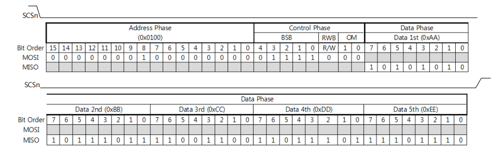

I want to use w5500 on stm32h7 board. Using HAL_SPI_Transmit_DMA() can send msg sucess.But Using HAL_SPI_Receive_DMA() can receive data sucess one time,and run second time,the DMA status is busy tx,and the lock status is locked.
the picture is w5500 receive data timing
