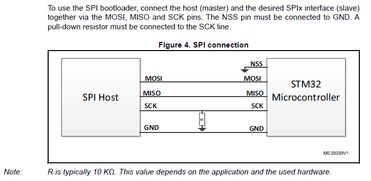

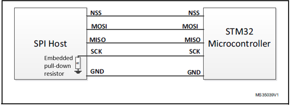

Application Note AN2606 specifies the pinout configuration as follow (p38/426 - Figure 4):With this configuration, there is no way to get any form of communication from the slave bootloader. I must connect both NSS together and configure it as hardware NSS output signal in master software. It looks like this:
With this configuration, slave bootloader is active on SPI interface (data on MISO).

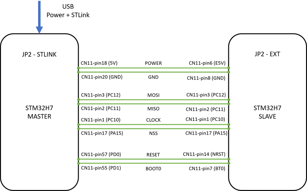

Below is the two boards connection schematic, note that:
- SPI3 is used both by Master and Slave, Master’s SPI GPIO configuration has been accordingly updated to match default bootloader pinout to avoid any confusion or connection error.
- SPI clock’s prescaler is set to 256 to get as low frequency as possible. Other parameters are set as specified in Application Note AN2606 (p263/426 – Table 103)
- Power is transferred from Master to Slave (Slave JP2 set to EXT)
- Master control Slave’s NRST and BT0 through GPIOs
- Master’s USART3 is configured to send datas through USB Virtual COM Port (print Master’s status & data)

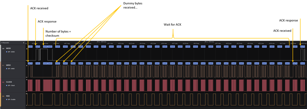

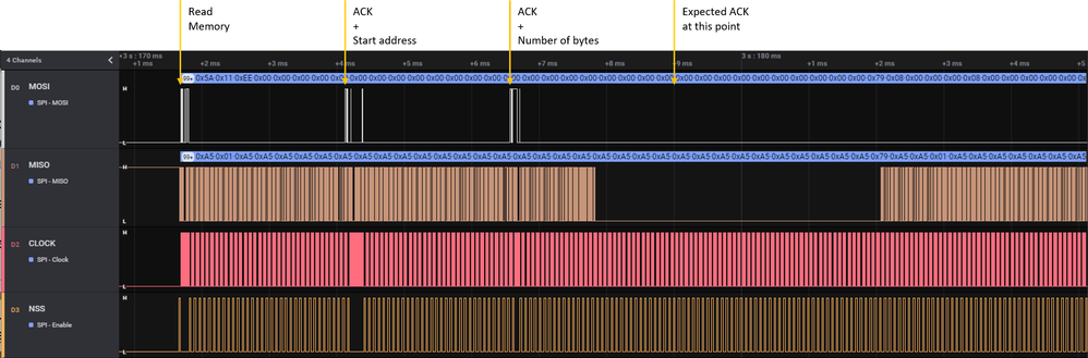

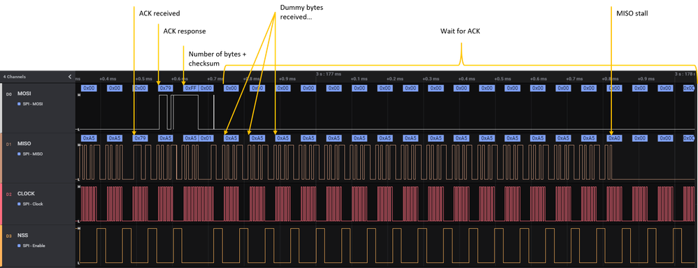

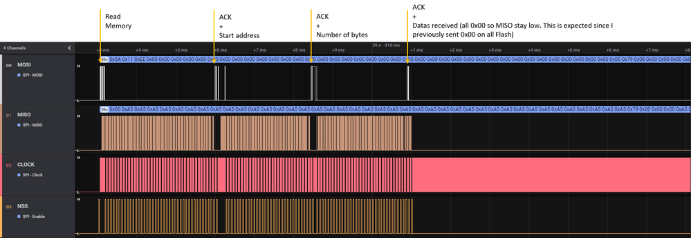

Then, I loop over all the above commands, each time restarting the Slave’s bootloader to see if the communication is nice and stable. It works well for a long time but at some point, an error occurs while waiting for the Slave’s bootloader ACK or NACK; which is I don’t receive any of these. I reset the Master and try again but the error is still present. I plugged the Saleae on MISO/MOSI/CLK/NSS to check the communication, and surprisingly I see that MISO stops talking for a long period of time before starting again. When this kind of error occurs, the error is at the exact same byte for each following test. Here is a shot of the phenomenon, during Read Memory command:
Here is a shot of the same function in case it works well:
I did other tests but didn’t saved the Saleae capture. Once, I saw the MISO stalls right after the two bytes FF 00 have been sent.
