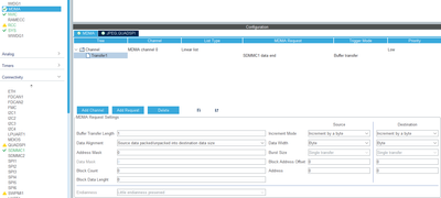

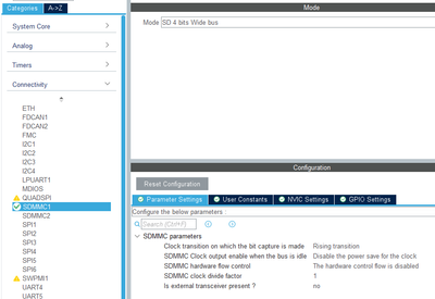

Could you please provide the configuration process in STM32CubeMX?
This is my current configuration.
The following is my test code.

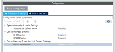

May I ask if the use of the DMA function involves the configuration of the MPU?
I haven't enabled the function of the memory protection unit at present.
Can it be used normally if the MPU is not configured?
If configuration is needed, please provide the correct configuration information.
