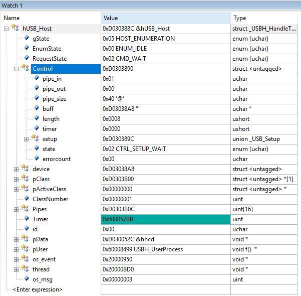

keil debug info:
I don't know why such a problem occurs, please help me.
