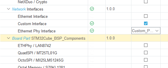

My processor board uses STM32H743V. The Ethernet chip is KSZ8081, MII mode. I also use AZURE RTOS and NetX. I tried using CubeMX to generate an application, but it always gives me some error when I compile the program. I tried different combinations, but no way to solve the problem. Does anyone know how to set up CubeMX and Azure NetX in MII mode? Does anyone have an example?

Hi @TVuck.1 ,
that's clear now :smiling_face_with_smiling_eyes: !
IIUC, you want to use the NetXDuo Ethernet driver + KSZ8081 PHY interface
If it is the case then you'll need to select the "Ethernet interface" component instead of the "custom interface" and keep "Ethernet Phy Interface/Custom_Phy"
because the Ethernet Interface is Phy agnostic and it is common to all the STM32H7xx MCUs. The "Custom Inteface" is intended for writing a new driver for other interface than the Ethernet (WiFi, 3G modem...).

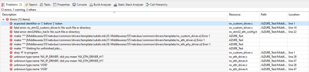

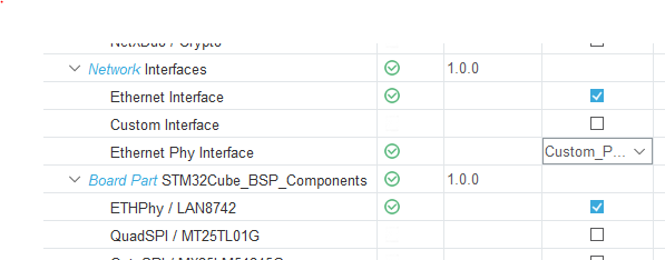

Hi Haithem

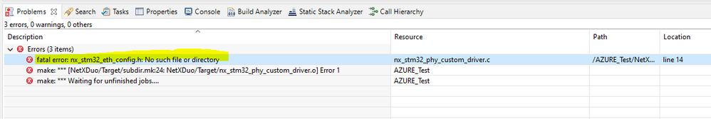

I changed the settings in the project, but I still can't compile the project. The project returns a lot of mistakes.
Project settings:
List of errors:

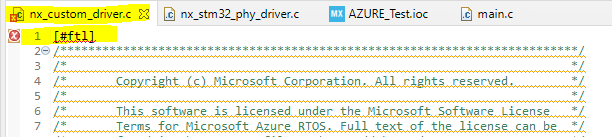

For example. See line 1 in file nx_custom_driver.c:
I send you a complete project generated by eclipse export in attachment. Ioc file and source files. Please, try to compile this project on yours computer.

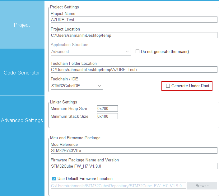

2021-04-05 6:11 AM
This is a corner case that we are investgating. In the project settings you'll need to uncheck the "Generate under root" option as shown below.
regards
Haithem.

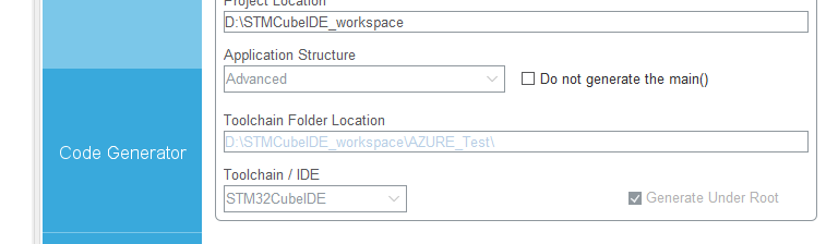

2021-04-05 7:03 AM
It is impossible to unchek it. This part is blocked on my project. How to unblock this check box??
