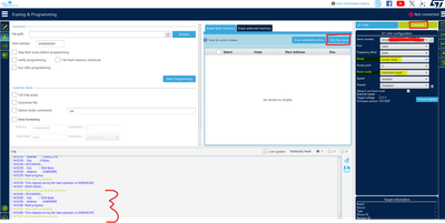

This is the error message I receive from stm32cubeprogrammer when I try to connect the dev board
2025-03-10 12:04 PM
It's always after posting that I find a solution LOL
But for anyone who runs into this issue, here's my solution:
You need to use the stm32cubprogrammer.
Setup the ST-LINK configuration:
1. change Mode to Under reset
2. change Reset Mode to Hardware reset
3. click on Connect
From there you just have to click Full Chip erase and that will erase your flash :D
