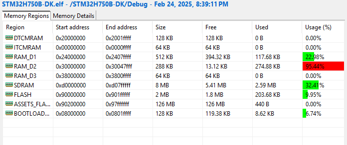

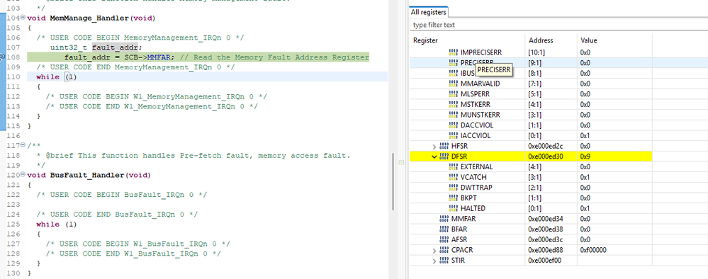

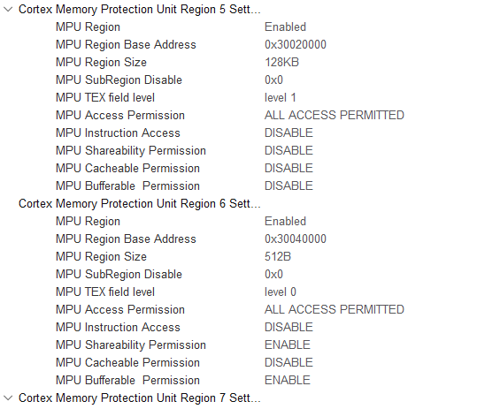

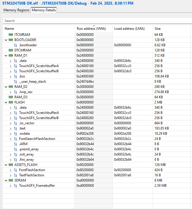

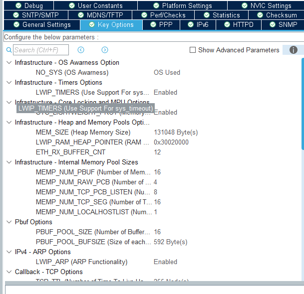

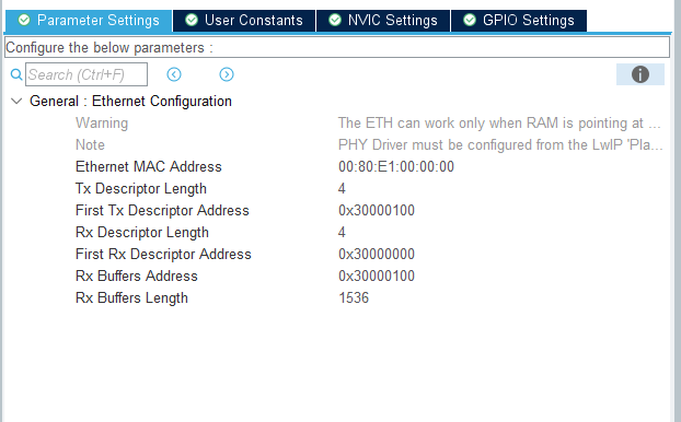

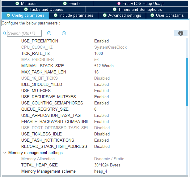

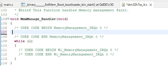

          I have setup the following parameters to run ETHERNET Using STM32H750B-DK Board and I am getting void MemManage_Handler(void) Error.

Same MPU config and same memory usage.
Without Using FREERTOS the above specified Program runs perfectly, But After integrating ETHERNET and LWIP I am getting MemManage_Handler(void) Error.
