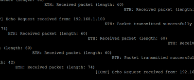

I am not passin after netconn_accept. i have tried running a client from windows PC using telnet and it exits with timeout.
2025-07-22 4:57 AM

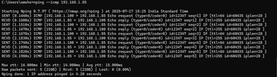

Hi the issue is resolved, established ping from pc to mcu
the issue is with implementation of lwipopts.h
