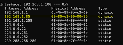

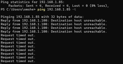

3. Initially tried to establish a connection with my PC and try a ping test.
4. I'm facing ARP Resolution initally but somehow it resolved and now i can find my MCU ip and mac address on my PC, but still ping is not reachable.

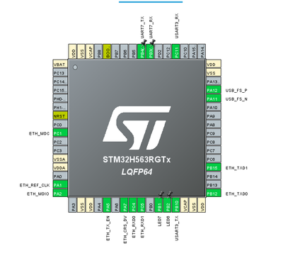

2025-07-01 4:04 AM - edited 2025-07-01 4:53 AM
Hi thanks for the reply @STackPointer64 . Please find the details below
this is the IOC view and i uploaded the file as well.

3. ARP resolved and able to find the device PC's ARP list.
4. ping isn't getting reply, but not showing not reachable as well just request time out.
5. I can see the traffic on wireshark.

2025-07-02 3:54 AM
Hello @aravindpv,
After analyzing your STM32CubeMX configuration, I suggest increasing your thread stack size to at least 256 words instead of 128. If the issue persists, consider adding an MPU configuration to reduce the risk of memory corruption. Additionally, I recommend reviewing the projects in the repository linked below to compare configurations. Once the ping works, you can take inspiration from the TCP client implementation for your Modbus project.

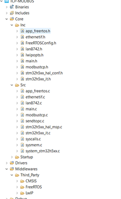

2025-07-07 2:47 AM - edited 2025-07-07 2:47 AM
Yes i followed the steps and tried building LwIP_TCP_Echo_Server
2025-07-07 2:50 AM
Could you please attach your project so I can review it? If the project is private, feel free to send it to me privately.
2025-07-07 3:32 AM
@STackPointer64
Hi please find the attachment
