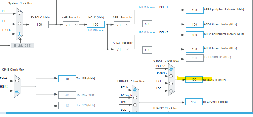

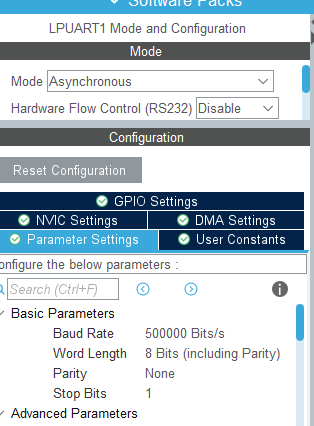

Hi everyone, I have a problem about UART_ReceiveToIdle_DMA. I receive data with baud rate 500000bits/s. I checked the reference manuel, it says stm allows to baud rate up to USART Clock/3 and my clock is 150Mhz.

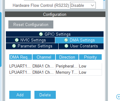

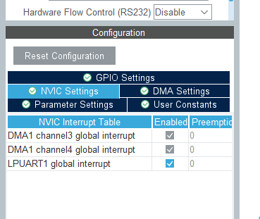

1) ReceiveToIdle_DMA does not detect Idle. I enabled NVIC and DMA settings and used RxEvent Callback. Even though there is Idle in data, it keeps receiving and writes to all buffer.

I'd assume something else is amiss if the DMA is incorrect, or started too late. Check DMA unit status.
Perhaps implement with interrupts and get some data and timing metrics. Assume its not actually zero length, use sizeof()

Thanks for your reply and apologize to answer too late. I change my IC and reset enable pin in error and rx callback and problem solved.
HAL_GPIO_WritePin(DNM_EN_GPIO_Port, DNM_EN_Pin, 0);
And also the quotation that you give from the kod, it was a mistake, I ought to write different size I change it.
