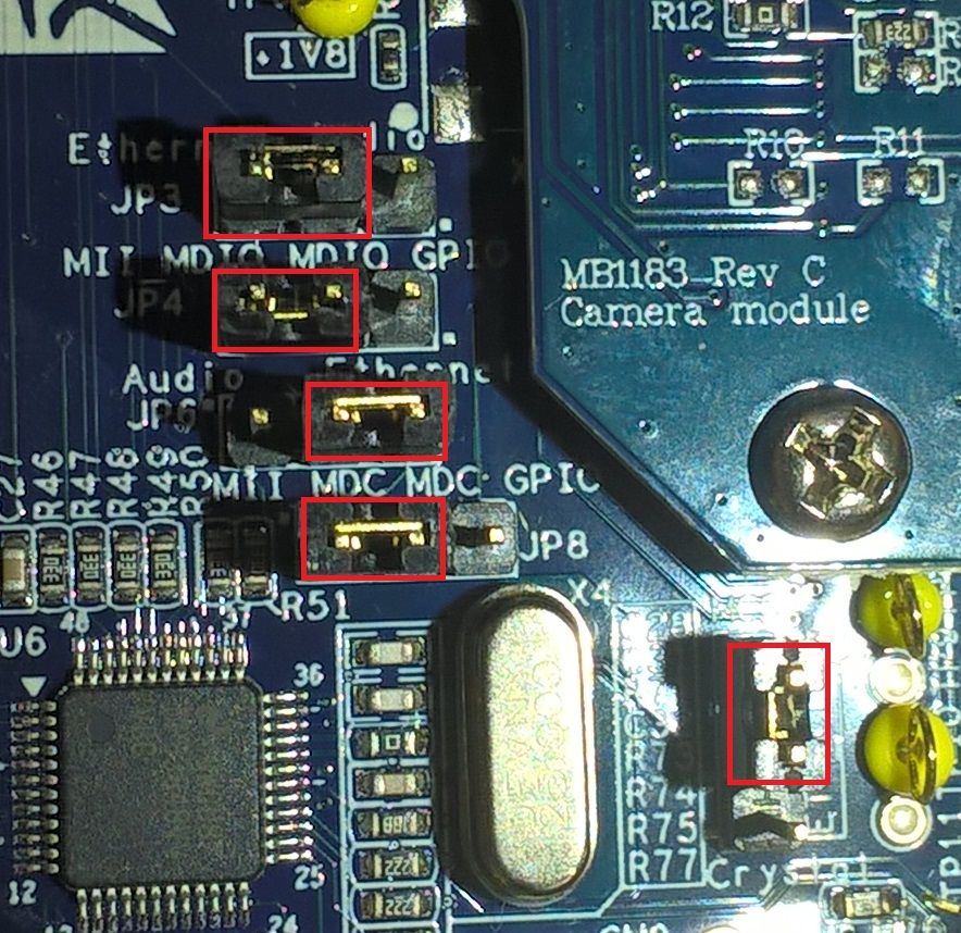

1. Change some jumpers according to the user manual page 23.

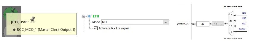

2. Using the STM32CubeMX, i've made the following configurations
3. In the header file lwip.h i have extern the following variables (used in lwip.c file) because they will also be used at freertos.c file :
extern struct netif gnetif;
extern ip4_addr_t ipaddr; extern ip4_addr_t netmask; extern ip4_addr_t gw;4. In the source file
