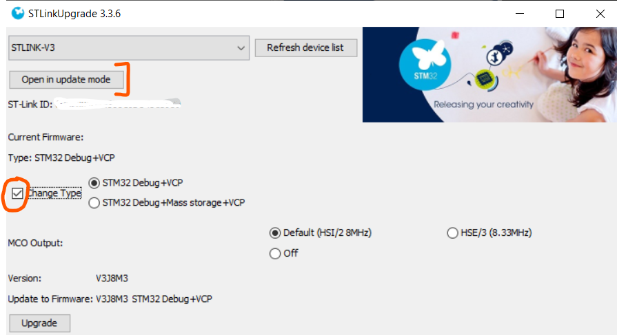

Thanks to all that replied, I have found an answer.
The issue was that company policy around USB devices would not agree with the nucleo board being mounted as a USB device. We do not use the USB storage on the nucleo board, so within the STM32Cube Programmer application, there is an option to do a firmware upgrade for the ST-LINK debugger. When doing the upgrade, you can change its type to remove the Mass Storage option.
0693W00000HnvlFQAR.pngThis fixed the issue!
