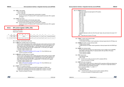

2024-10-01 1:21 AM - edited 2024-10-01 1:23 AM
If something does not work as expected, always start with reading out and checking content of registers (with having in mind that debugging is intrusive).
Data size is in CR2, not in CR1.
Generally, never use Cube-defined symbols (constants) as they may be different than what you think; use exclusively those defined in the CMSIS-mandated device header. This has the added benefit that they contain the register name, so it's less likely you apply them to inappropriate register. E.g. here:
SPI1->CR |= (0b0111 << SPI_CR2_DS_Pos) // 8-bit
