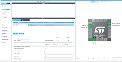

2025-07-31 3:38 PM
After reading STM32G431KB DAC DMA not working - Page 3 - STMicroelectronics Community
in the DMA setup, change Data With for the Peripheral to Word.
hth
KnarfB
2025-07-31 1:15 PM
You may find the raw interrupt handler in the *_it.c file which dispatches the irq to HAL. Set a breakpoint there and, if it is hit, follow the path through HAL.
hdac1.DMA_Handle1 = &hdma_dac1_ch1; is should not be needed. See __HAL_LINKDMA in HAL_DAC_MspInit.
How are the DMA settings? Maybe you add the .ioc.
hth
KnarfB
2025-07-31 1:44 PM - edited 2025-07-31 1:45 PM
2025-07-31 3:38 PM
hth
KnarfB
2025-07-31 3:53 PM
Is the DAC working as expected? Is the NDTR register changing? Is the Timer CNT register changing? The rate of samples is pretty low. It'll take a few seconds for a half-buffer to be pushed out.
