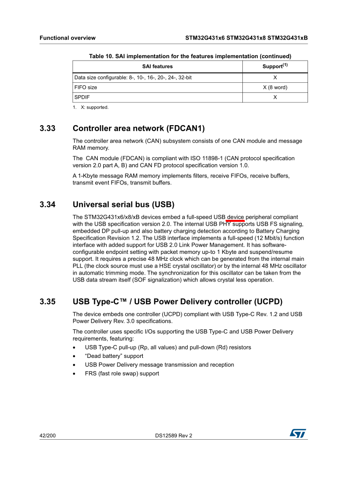

here an extract of the STM32G431x Datasheet. BR, JP​

@JDUMA​ ,
I am not talking about PD, it's completely separate from the USB data transfer.
What I am talking about is the USB "data" module. In G4, it is Device only:
but look at the initial post here, it says DEV/HOST, indicating, that G0 might have a USB module capable of being either USB Device or USB Host.
Is this the case, or is that picture a blunder?
JDUMA
​Yes that's correct (as this is shown in the portfolio overview), new STM32G0Cx are planned by next year with a USB device / host comm interface. Switching from device to host or vice versa will be possible by using "data swap" command encapsulated in the USB PD protocol. BR, JP
