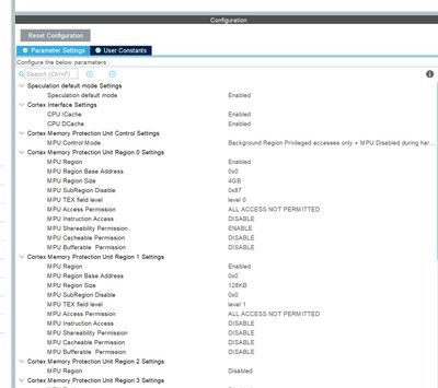

thanks for the reply jumman_JHINGA , this is my .ioc made with IDE version 1.18.1
if you need other files just ask me.
