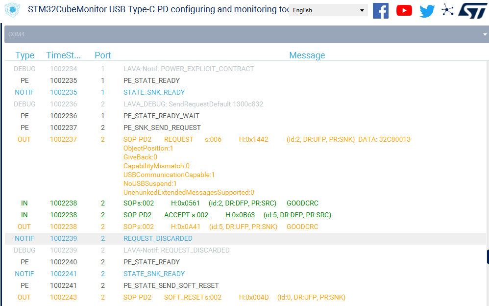

Sometimes, on the Sink port, I see the "REQUEST_DISCARDED" message (Type: NOTIF).
The timing I see the message is after "REQUEST" sent, "GOODCRC" received, "ACCEPT" received, and "GOODCRC" sent.
Message exchanges are normal, but PE reports "REQUEST_DISCARDED" even though message exchanges are successful.
And then, the Sink sends a "SOFT_RESET" message, and sends "HARD_RESET" eventually.
Since it is invisible to me where the "REQUEST_DISCARDED" message comes from (probably it happens in the STM32 static library), I have no idea what is happening inside.

2023-02-10 11:23 AM - edited 2023-07-14 11:40 AM
Hello @nicolas P ,
I have Dual-Role (UCPD1) and Sink (UCPD2) port in my application.
I am sending Request data message in several cases, and encounter "REQUEST_DISCARDED" occasionally.
The below is what I see when that happens.
I added a snippet and screenshot of the debug messages.
(If you don't recognize functions or values in the snippet, they are created by myself.)
I have no idea how I can debug this error.

2023-02-15 11:56 AM
Hello @Nicolas P ,
Each port is connected to a different device.
DRP port (Port 1) sends PR Swap control messages to another DRP device, and Sink port (Port 2) sends Request data messages to the other device attached.
And, the Sink port issues the messages depending on a power role of the DRP port.
I attached a .cpd file.
Please see timestamp from 1024146 to the end to check a error sequence.

}If I understand correctly, you want to send a request whenever a port is in SNK_READY.
In the trace we see that port 1 (the DRP one) is in sink_ready, but the request is sent on port 2 (the sink only port). Is it what you want to do ?
Don't you need to specify which port will send the request ?
For the moment I don't understand why there is a discard.
2023-02-16 11:26 AM
Hi @Nicolas P ,
Your understanding is correct.
SendRequest() and SendRequestDefault() send a Request message on the Sink port side. The port number is specified inside of the functions.
In which cases is the REQUEST_DISCARDED message generated?
Where do 'NOTIF' type messages come from?
If they are from PE layer, it is going to be very difficult for me to find the error since I believe the messages are generated by the USBPD core library.
(I am using USBPDCORE_PD3_FULL_CM0PLUS_wc32.a.)
