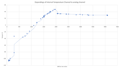

When changing the voltage on AN11, the internal Temperature Value also changes. Here Some Examples:
| Raw Value of AN11 | Converted Temperature of CPU in °C |
| 70 | -104 |
| 74 | -106 |
| 819 | -25 |
| 1449 | 23 |
| 1924 | 47 |
| 2170 | 34 |
| 3288 | 31 |
| 4001/ 4095 | 30 |

Considering the variation of CPU temperature and your external measurements, it seems that you are using the external conversion result to compute the internal CPU temperature.
Can you please check by converting the internal TEMP_SENSOR only while keeping variation on your external sensor?
Best Regards,
Gwénolé
2023-08-11 1:53 AM - edited 2023-08-11 1:55 AM
That's what I do. I convert the second value of the dma and send the first value only as reference (Take a look at the last code lines I provided). When turning my potentiometer from left to right, the value of AN0 changes from about 10 to 4095. I think that's the right value, so the other one must be the temperature value.
I also tried different pins for the external signal but all of them have the same result. I hardly doubt that my CPU has a temperature of -100°C :D
