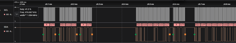

The problem almost always presents as the host MCU reading back a non-valid ACK byte (according to AN4221) - I've seen 0x4D most recently which does not match 0x79 for ACK, 0x1F for NACK, or 0x76 for BUSY. It is usually the first response when polling for an ACK after writing a block of byte to memory. If the host MCU tries to read again, the G0 will clock stretch indefinitely.
Invalid read byte
Subsequent read:
And the G0 will need to be reset to release the I2C lines. We have verified it is the G0 pulling the lines low and not the host MCU by looking at the analog voltage - the U5 seems to have a stronger driver and will pull the lines 50-100mV lower than the G0.
Here is the start to the "Write No-Stretch" command right before the above reads:
The memory address is correct, and the G0 is responding with ACKs appropriately.
