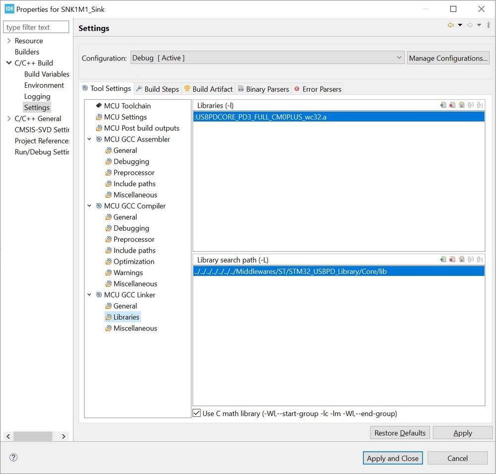

2021-03-29 9:50 AM
@Yohann M.
Yes, that was the problem. Both the library search path and the libraries section were empty.
For some reason, CubeMX no longer adds these settings to the project configuration file when regenerating the code. Worse still, the libraries setting is cleared each time the code is regenerated, even if it was previously set. Oddly enough, the library search path is not cleared after regenerating.
This is also a problem for newly created projects, which is very strange because CubeMX used to add this setting to new projects automatically, at least it did a few weeks ago.
Anyway, after getting the project to compile, I confirmed that both stacks now seem to work.
Any estimate for when a new release will come out patching these bugs? It is very annoying to have a long list of edits that I have to make to the code every time I regenerate the project.
Thanks,
Nathan

2021-03-30 9:39 AM
Good afternoon @Yohann M.
Here is my IOC file. I am using CubeIDE 1.6. I have not tried generating the project with the standalone CubeMX (the version on my system is also 6.2.0). It's a very strange error because it was working fine for the last couple weeks. It only started erasing the library from the linking configuration after I played around with the X-CUBE_TCPP project; although that's probably just a coincidence.
My project is very simple: it's just starting with a Nucleo-G071RB dev board template and turning on enough stuff to get the USB PD ports up and running. More or less just following the USB-PD tutorial video.
Thanks for all your help.
