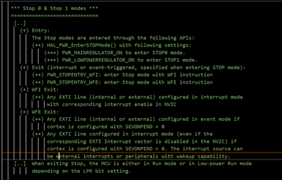

Hello @gailu96
To enter stop1 mode please read the section how to use the HAL PWR driver.
For more details, please refer to the RM0454 section 4.3.7

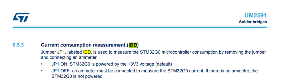

Hello @gailu96
To measure the current consumption, you should remove the IDD jumper and connect your amperemeter.
Please refer to the UM2591 for more details.
