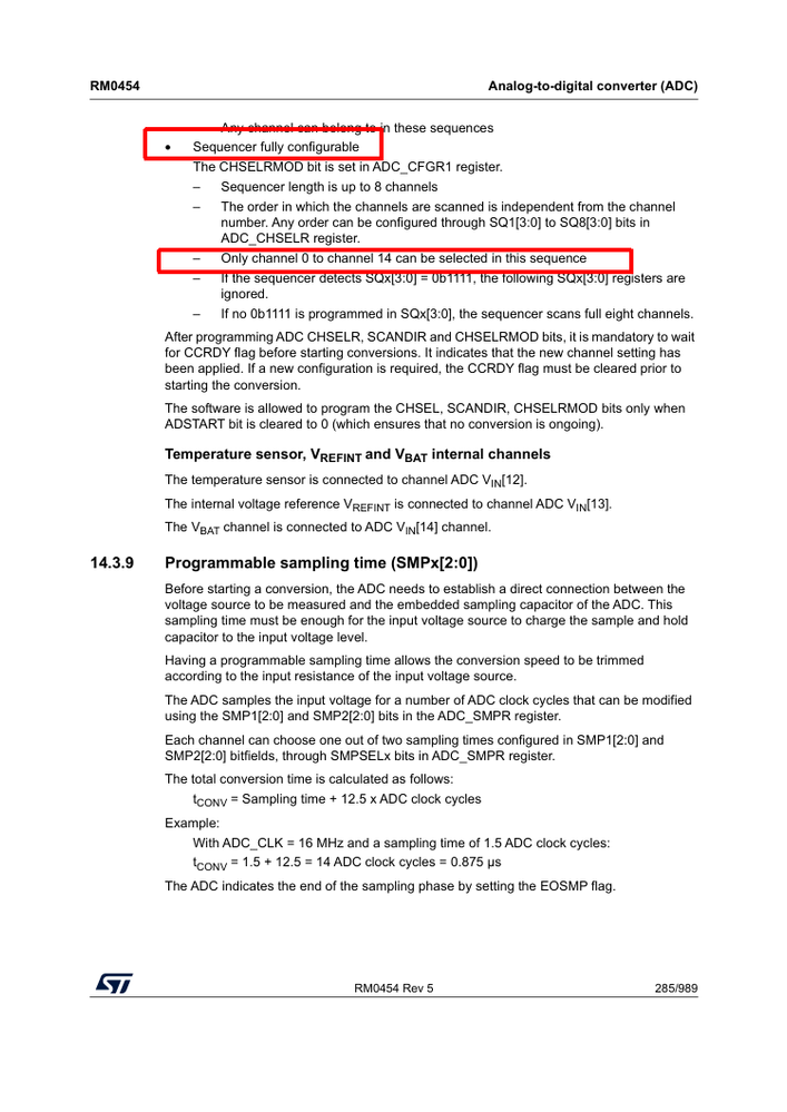

Oh, so you probably attempt to use the fully configurable sequencer mode (I don't know how is it called in Cube/CubeMX, I don't use Cube). That has this limitation, as documented in the RM (and CubeMX attempted to prevent you from going against it):

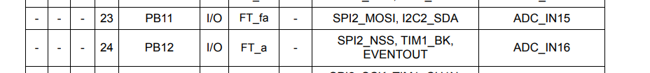

shows no problem with PB11 and PB12 pins ,
the pins should give correct ADC values :
You choose in15 and 16 ?

As you see on CUBEMX, it can not determine channel number only if PB11 or PB12 is choosen.
Even though CUBEMX cant determine channel number, I rewrite sconfig.channel as for channel 15 (PB11) and channel 16 (PB12).

the old CHSELRMOD problem....see :
https://community.st.com/t5/stm32-mcus-products/stm32g030-adc-issue/m-p/316178
vs
So set CHSELRMOD = 0 , to select ch 0...18 .
