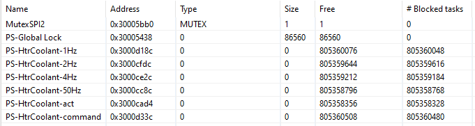

2. Here's a screenshot of the Semaphore view:
2A: MutexSPI2 is created by CubeMX as a dynamically allocated Mutex using the CMSIS OS wrapper.
2B: PS-Global Lock is created with
mutex_init(&lock,"PS-Global Lock");where
int mutex_init(mutex_t *_m, const char* mutex_name) {
SemaphoreHandle_t *m = (SemaphoreHandle_t *) _m;
*m = xSemaphoreCreateMutex();
vQueueAddToRegistry((QueueHandle_t) m,mutex_name);
return 0;
}I'm guessing that since the 'mutex' is being defined as a Semaphore is why it's not showing up on the list as a MUTEX, but I don't understand why the "Size" and "Free" values are.
2C: The remainder of the Semaphores are created by
ps_queue_t *q = calloc(1, sizeof(ps_queue_t));
mutex_init(&q->mux, mutex_name);
semaphore_init(&q->not_empty, 0, sem_name);where
int semaphore_init(semaphore_t *_s, unsigned int value, const char* sem_name) {
SemaphoreHandle_t *s = (SemaphoreHandle_t *) _s;
*s = xSemaphoreCreateCounting(INT32_MAX, value);
vQueueAddToRegistry((QueueHandle_t) s,sem_name);
return 0;
}I don't understand why the Free and # Blocked Tasks values are so large (other than they look like
pointers to code addresses).

That’s a limit of STM32CubeIDE’s FreeRTOS awareness plugin, not FreeRTOS itself. The plugin only displays the first N kernel objects (around 64) for performance reasons. Objects beyond that still exist and work; they’re just not listed.
To inspect objects beyond that:
- Register them with vQueueAddToRegistry().
- Use the Expressions / Memory views to inspect the handle directly.
There’s no public setting in CubeIDE to increase this limit.
The issue is how you add objects to the queue registry. vQueueAddToRegistry() needs the handle, NOT the address of the variable. Passing m/s makes the registry point at the wrong memory, so CubeIDE tries to decode random data as a Queue_t, and by consequence you see huge or strange values for Size, Free, and Blocked tasks.
Correct code should be:
vQueueAddToRegistry((QueueHandle_t)*m, mutex_name);
vQueueAddToRegistry((QueueHandle_t)*s, sem_name);
They’re debug info only:
- For a mutex/binary semaphore: Size = 1, Free = 0/1.
- For counting semaphores: Size = max count, Free = current count.
- # Blocked tasks helps diagnose contention.
They don’t affect runtime behavior; wrong values just mean the debugger looked at the wrong memory because of the registry bug, not that your synchronization is broken.
