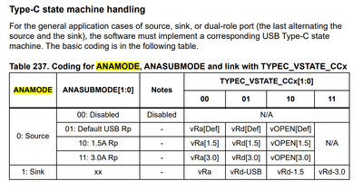

Hello @Tadeas_Pilar,
As I said you don't need those two resistors, you have to remove them. UCPD IP already includes resistors that you can configure using ANAMODE and ANASUBMODE of the UCPD control register.
In your case, ANAMODE must be set to 1.
Best Regards,
LECHEVESTRIER Lucas
