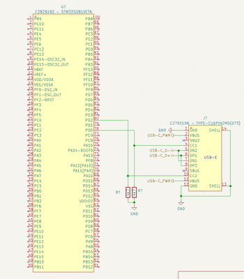

2023-09-28 9:44 AM
The CC1 and CC2 lines are connected like this
