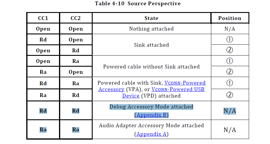

The difference is mainly on the resistor value:
So you can use as model the ACCESSORY detection to manage the DEBUG detection which is Rd detection on both CC lines.
