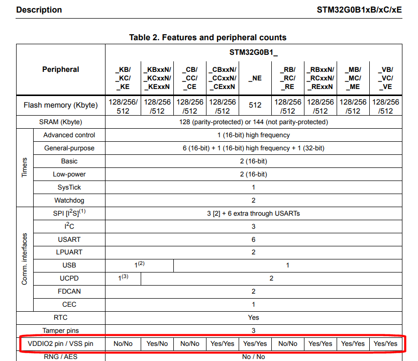

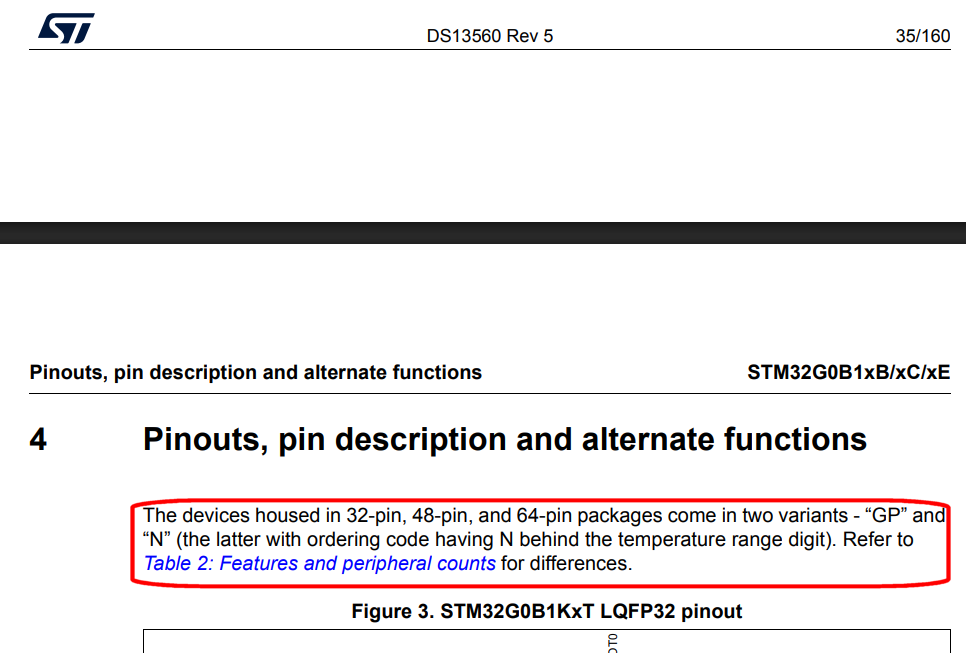

@kuda1311 wrote:Waht is the difference between KBU6 and KBU6N?
See the datasheet text which is immediately above the screenshot which @AScha.3 posted:
and Table 2:
2025-12-05 11:34 AM
Certainly seems that way. I doubt the marking is the same for both of them.
