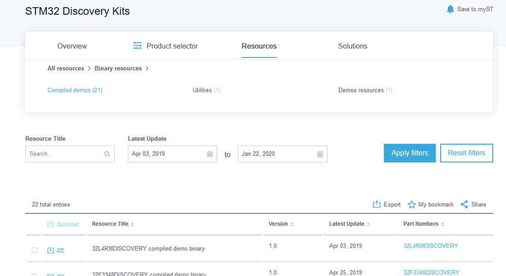

2020-03-09 12:00 AM
While you mention 'F769I-DISCO, 'F7508-DISCO and F746G-DISCO in one post, and I don't know which one do you have and want software for, the fact is, that for both 'F769 and 'F746 DISCOs the binaries are missing from the list at https://www.st.com/en/evaluation-tools/stm32-discovery-kits.html#resource->Resources->Binary resources (can't give a direct link #idiotic_ST_web_design)
@Amel NASRI it's been quite a while since the binaries started to be separated from their respective Cubes, can this please be completed? 39 DISCOs are listed, and there are only 21 binaries.
Thanks,
[PS] I faintly recalled this has been already discussed - and indeed, https://community.st.com/s/question/0D50X0000BMGuZqSQL/stm32f769-discovery-kit-demo-firmware

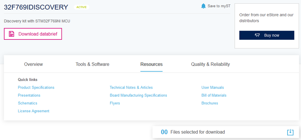

2020-03-09 1:20 AM
Thanks a lot,
Indeed, while I have "F769I-DISCO", I have just copied the wrong path as was making the post.
I have downloaded the compiled hex for my board and I will try (not sure if it work...I have a filing, that problem may be barried a bit deeper).
Now I have realized, what " #idiotic_ST_web_design" does mean:
If you open a specific page for the evaluation board (what i did initially), you do not see any binary files to downolad:
https://www.st.com/content/st_com/en/products/evaluation-tools/product-evaluation-tools/mcu-mpu-eval-tools/stm32-mcu-mpu-eval-tools/stm32-discovery-kits/32f769idiscovery.html#resourceBUT, if you go to a general page with all the boards, then you see "compiled demos" and can find an appropriate board in a list:
https://www.st.com/en/evaluation-tools/stm32-discovery-kits.html#resourceThanks again for help.

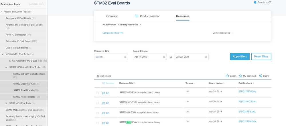

2020-03-09 1:26 AM
Can you actually find the binary for 'F769 DISCO on https://www.st.com/en/evaluation-tools/stm32-discovery-kits.html#resource ?
2020-03-09 2:35 AM
Yes,
Actually, I have downloaded it from direct link provided by you in one of the threads:
But also it can be found in a list of resources for STM32 Eval Boards (35) (Not STM32 Discovery Kits (38)) list:
So, thanks again.
2020-03-09 2:49 AM
But that's for the EVAL board, not the DISCO board.

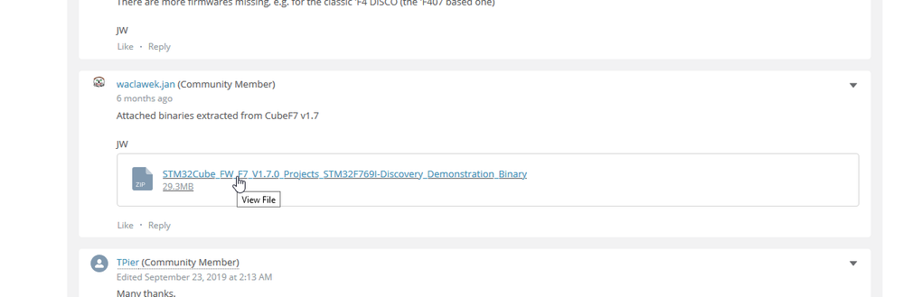

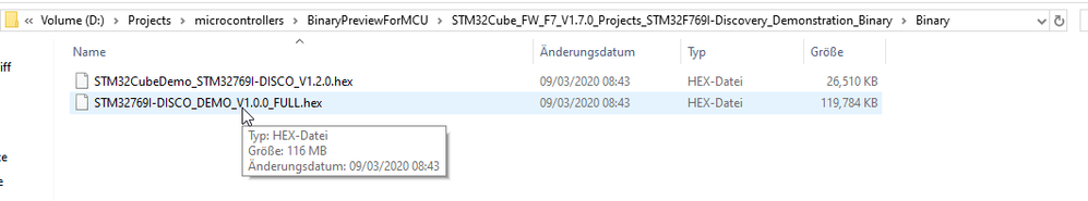

2020-03-09 4:29 AM
Dear Jan,
I am really greatful to you for forgiving my carelessness (I am right now depositing CoGd in a lab), and indeed, on page STM32 Eval Boards (35) there are no binary files for my discovery Kit.
However, on relevant to my Discovery kit web-page (STM32 Discovery Kits (38)) there are also no binary file.
I have downloaded it from the link in your old message.
This should be it:
Just to clerify, which kit I do have:
I do have: STM32F769I-DISCO
https://www.mouser.de/ProductDetail/STMicroelectronics/STM32F769I-DISCO?qs=%2Fha2pyFaduiYiBFkQrlha0fX%2F0DpQB6dHjz%252BO14m1oS24%252BLdGADvYQ%3D%3DBut how could it be that there is no binary file on the official web-page, althoug it is mentioned in user manual? Pity.
