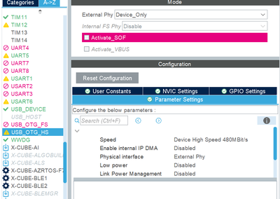

In case anyone else has this problem, I think I found a fix
The option 'Enable Internal IP DMA' must be disabled. The problem is not to do with buffer alignment as I checked this, it seems to be a timing issue and may be specific to the use of FreeRTOS.
Note that the option 'Use dedicated end point 1 interrupt' must also be disabled as that also prevents USB comms.

2024-09-25 3:33 AM
