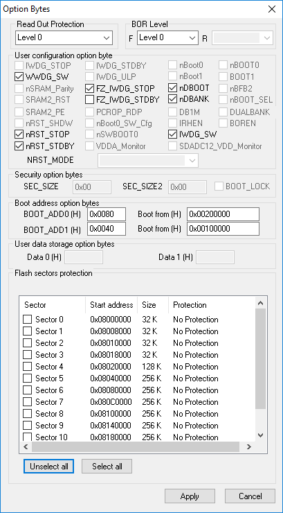

I have followed pattern 9 from the AN2606 documentation checked my optionbytes with ST-Link and are as set as follows:
Can anyone please shed some light on this. Has anyone been able use DFU mode on the STM32F769 Discovery Board?
