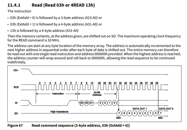

2025-07-12 7:02 AM
Accoding to the S25FL256S Datasheet the 0x13 read command needs a 32 Bit Address, but You are sending only 24 Bit.
QSPI_ReadData
Reads data starting at the given 24-bit address using the Read Data command (0x03).
Datasheet reference: Section 11.4.1 (Normal Read).
HAL_StatusTypeDef QSPI_ReadData(uint32_t address, uint8_t *pData, uint32_t Size)
sCommand.Instruction = CMD_READ_DATA;
sCommand.InstructionMode = QSPI_INSTRUCTION_1_LINE;
sCommand.Address = address;
sCommand.AddressMode = QSPI_ADDRESS_1_LINE;
sCommand.AddressSize = QSPI_ADDRESS_24_BITS;
sCommand.DataMode = QSPI_DATA_1_LINE;
sCommand.DummyCycles = 0; // Normal read does not require dummy cycles
sCommand.NbData = Size;
if(HAL_QSPI_Command(&hqspi, &sCommand, HAL_QSPI_TIMEOUT_DEFAULT_VALUE) != HAL_OK)
return HAL_ERROR;
return HAL_QSPI_Receive(&hqspi, pData, HAL_QSPI_TIMEOUT_DEFAULT_VALUE);

2025-07-15 10:57 PM
Hi @MHoll.2,
Yes, I tried using this command as well and observed the same issue. After checking, I noticed that the first byte is sent, but when I try to read the memory for the first time, it does not read the first byte. However, after the second read, I can read the full data bytes. So, I added a small delay, and it is now working properly.
Thank you for the help and suggestions.
