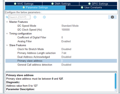

2025-07-15 3:40 AM
Hello @maya16
Is the slave adresse = 0x42 << 1?
2025-07-15 4:54 AM
attach the .ioc file.
2025-07-15 5:17 AM
yes
