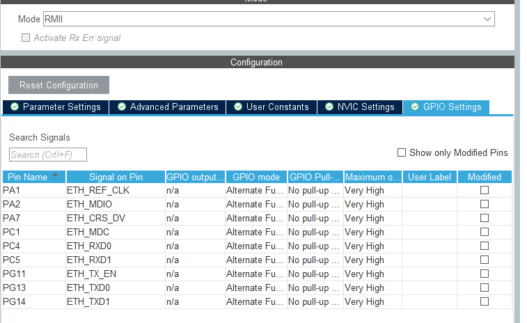

So I have this STM32F750 Discovery board with RMII Ethernet connection and I have another H745 Discovery with MII Ethernet.
I am trying the same project in both of them, and it's working in MII but not in RMII.
I tried every possible solution I can think of, like the MPU configurations, different memory locations for the DMA Descriptors, with/without RTOS, but never got it working with the RMII.
The code executes fine, the Tx Buffer is updating fine, but somehow the connection is not working.

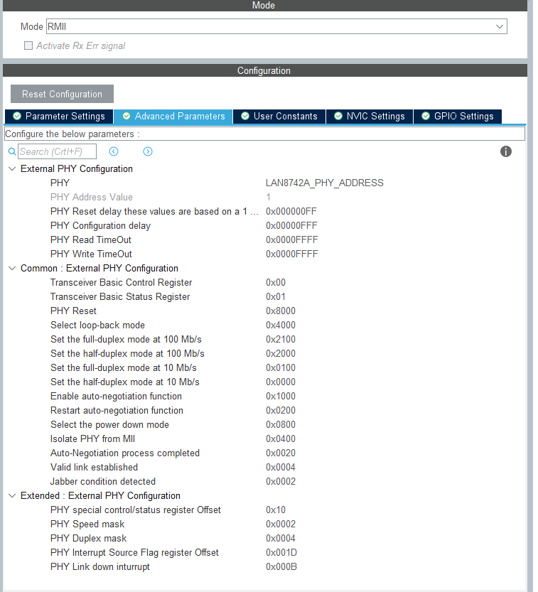

2021-06-22 11:28 PM
Got it Working.
In Ethernet configuration, PHY Address should be set to 0.
