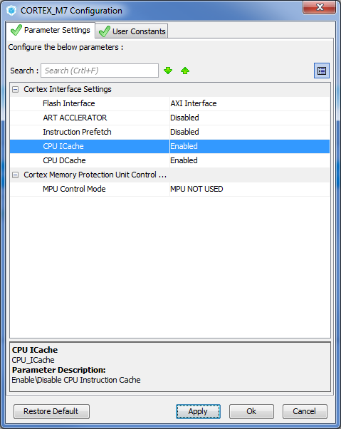

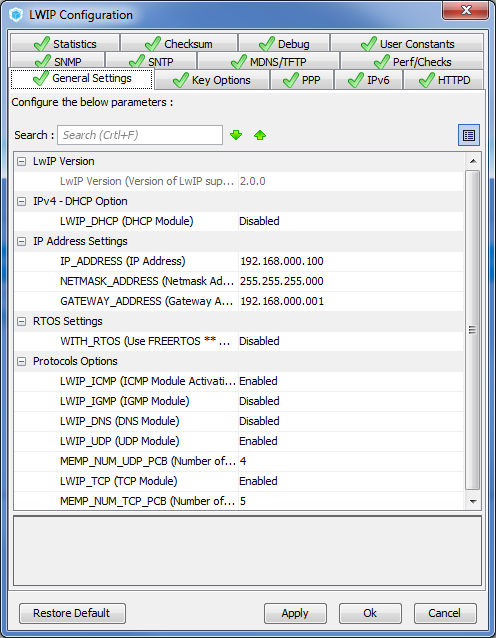

2017-05-01 2:10 PM
Hi Imen,
What is your configuration setting ?
Nothing is changed in the advanced parameter.
for LWIP settings only IP address is changed from DHCP to static.
Is the d
atacache enabled? if yes, in this case you should check your MPU configuration.I am not using MPU at this moment.
If you want me to use it than please suggest me the config.
A cache clean is required i
f the software is using cacheable memory regions for the DMA source/or destination buffers, in order
to ensure that all the data are committed to the subsystem memory.
by this function call: SCB_CleanDCache();
Also, you should c
heck the errata sheet related to your device to
check if you have the same conditions as described in the errata sheet.

Hello. You have two options like Imen wrote:
a) Do not enable CPU DCache.
b) Set SRAM not cacheable in MPU_Config
