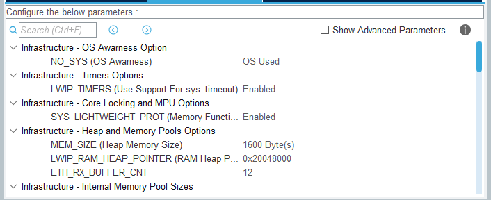

I am new to STM32F746-Disco and I was trying to develop an application starting from TouchGFX.
It went all good in developing a touchGFX app and use the generated .ioc and so on to configure a project but I've tried afterwards to configure the ethernet stack LWIP and so on but I was never able to communicate and ping the ethernet device.
I've tried on my local to run the ethernet example and I was able to properly ping the device but never been able to do it in the project configured with touchGFX.
The strange thing is that I can partially see some comunication such as ARP messages and so on but then the ethernet stack is not capable to reply to ping message. here a snapshot of the communication between my PC and the st board.
Does anyone might now what could be wrong in my configuration?
I've attached the .ioc

Hello @St32_User94, and welcome to ST community!
Integrating both TouchGFX and LwIP in the same project requires careful memory management to avoid buffer overlaps. I noticed that in your LwIP configuration, you specified only 1600 bytes for MEM_SIZE, which is insufficient. Since you set LWIP_RAM_HEAP_POINTER to 0x20048000, you are likely allocating 16 KB. Therefore, you should update MEM_SIZE accordingly and reduce ETH_RX_BUFFER_CNT to 10 so it fits within the 16 KB.
Please try these changes and let me know your feedback.
