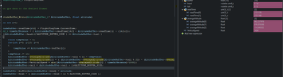

Hi TDK,
Thank you for answering
Tail is = 9
it means Tail%2 = 1
AltitudeBuffer->avarageAltitude[AltitudeBuffer->tail % 2]
means = AltitudeBuffer->avarageAltitude[1]
and
AltitudeBuffer->avarageAltitude[1-((AltitudeBuffer->tail) % 2)]
means = AltitudeBuffer->avarageAltitude[0]
AltitudeBuffer->avarageAltitude[0] = 962.237976
AltitudeBuffer->avarageAltitude[1] = 976.578308
AltitudeBuffer->avarageAltitude[2] = AltitudeBuffer->avarageAltitude[1] = 976.578308 - 962.237976 = 14.340332
But I got -14.340332

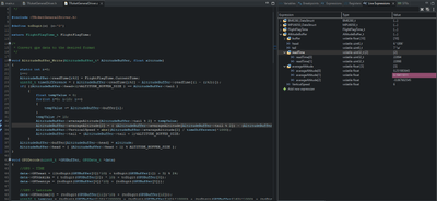

TDK
Super User
Okay, showing all variables, good, but you've cropped it so we can't see where execution is at when those expressions are evaluated. Note that "tail" is also modified in the given code. Set a breakpoint at the "AltitudeBuffer->avarageAltitude[2] =" line, and step over. If you do that, only the "AltitudeBuffer->avarageAltitude[2]" will show up with a red background, instead of everything, indicating it (and only it) was changed since the last break.

You change tail after the subtraction. When the difference was calculated, tail was 8.

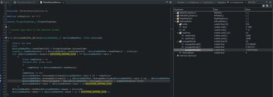

Hi TDK, Thank you for answering
I did what you said and you are right. When I add a breakpoint at this 3 lines I see it clearly.
Now tail is 7 and tail%2 = 1
its gonna be >> 0.19411011 - 0.251983643 = -0.0578735322
I am gonna try to fix that
