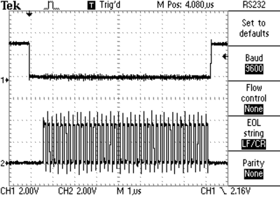

> How do you know this?
I see it on my oscilloscope. The chip select goes inactive after 2 bytes.

> or how you're interpreting the result.
