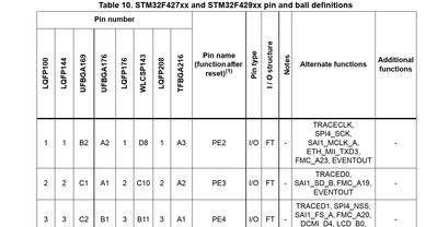

Can anyone please tell me? how can I separate gpio s which can be operated with 5v and 3v.

Try downloading a copy.of the data sheet? There's a table of pins and an FT designation for the 5V tolerant ones.
