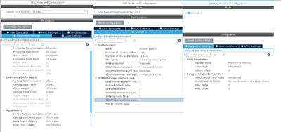

I found an example in my /STM32Cube/Repository/STM32Cube_FW_F4_V1.28.1/Projects/STM32F429I Discovery/Examples/BSP directory, and tried copying the code that involves the LCD from main.c over to my project and run it. The LCD still never displays anything. I have also tried playing with the configuration values of FMC, LTDC, DMA2D to see if that helped. It didn't. I suppose these configuration settings are actually important for the LCD to work properly. Here are the current settings: -
I appreciate any help I can get. I cannot find anything on the internet about this.

If you just want to set a red screen, you should be able to do it but you probably shouldn't modify the values of FMC and LTDC from the example, they probably already use the correct values for the display.
You can have a look at this guide and the 2 guides that are prerequisite for this one too.
