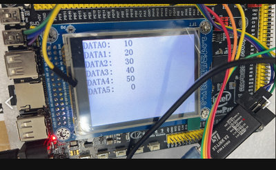

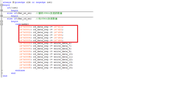

The FMC_Test.7z file contains two projects: FPGA_FMC and STM32_FMC.
In the FPGA_FMC section, I modified the default return values. The section highlighted in the first image shows the values that I want the FPGA to return: 11, 22, 33, 44, 55 and 66.

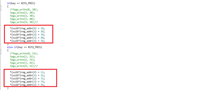

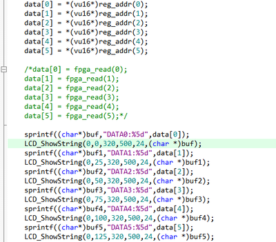

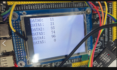

In the STM32_FMC module, I configure the operation of KEY1 and KEY2. When pressed, they set a value, as shown in the second diagram. This value also serves as verification that the FMC functionality has been successfully implemented. If not, the received data values will be either [10, 20, 30, 40, 50] or [11, 21, 35, 74, 96]. If it succeeds, however, the received data values will be [11, 22, 33, 44, 55, 66].
The two images below show the actual output after pressing KEY1 and KEY2.
