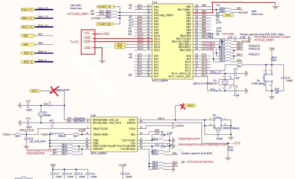

In fact, I have reworked a Nucleo board and saw the same behaviour. It re-enters into the bootloader mode after I leave the DFU mode. Attached is the schematic of the Nucleo board that I reworked.

Please, could you tell me how did you put your NUCLEO board (with STM32F411) in dfu mode ? I tried with mine, but it was been impossible and I don't really know why...
2020-05-27 3:48 AM
very simple
connect boot0 and 3.3v and use USB OTG via connect PA12,PA11,GND,3.3V with an USB CABLE to PC
you will see DFU mode on device manager
another variant is DFU file to convert into HEX with ST tools
and to upload HEX via ST-Link Utility ...
