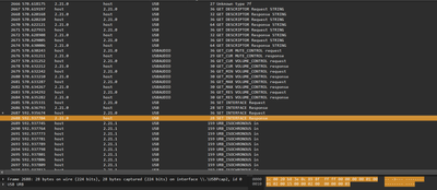

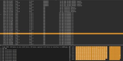

WireShark result:

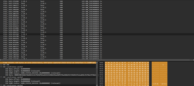

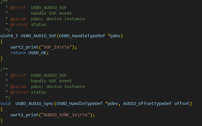

I tried marking all USBD_ClassTypeDef methods as serial output, like this:
Through the serial port output, I found that when the host sends the URB_ISOCHRONOUS IN request, although the MCU does not enter the USBD_AUDIO_DataIn function, it will enter the USBD_AUDIO_IsoINIncomplete function. After I added the function of sending data to the FIFO, the USB host can receive the data smoothly:

  * @brief  USBD_AUDIO_IsoINIncomplete
  *         handle data ISO IN Incomplete event
  * @PAram  pdev: device instance
  * @PAram  epnum: endpoint index
  * @retval status
static uint8_t  USBD_AUDIO_IsoINIncomplete(USBD_HandleTypeDef *pdev, uint8_t epnum)
	uart2_print("ISO_IN_In\r\n");
	FillAudioFrame();
    USBD_LL_Transmit(pdev, AUDIO_IN_EP, usb_buf, AUDIO_IN_PACKET);
  return USBD_OK;
WireShark:
I hope to give some inspiration to other confused people. Thank you to everyone who is watching this post.

WireShark:
