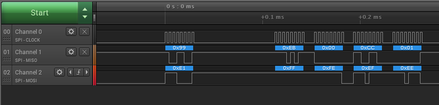

I am running a simple SPI transmit receive project with an STM32F411 (SPI Master) and STM32F303 (SPI Slave). Whenever I press the user push button on the STM32F4 Master, the Master will send a command byte (0xE1) through SPI and the STM32F3 Slave is expected to respond with 4 particular bytes. The snapshot of the logic analyzer below is what I expect to happen every single push button:

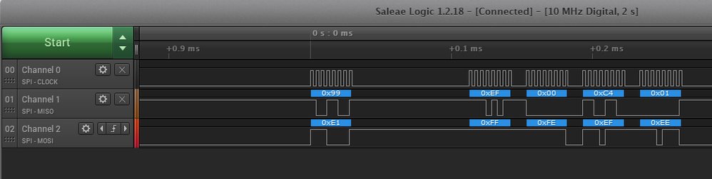

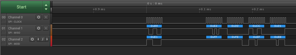

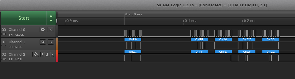

I could probably get the accurate SPI transaction above several times. However, most of the time, the snapshot below is what occurs:

It looks like the CPHA setting on your logic analyzer doesn't match the CPHA setting on your device. The waveforms are the same.
2020-07-21 6:11 AM
2020-07-21 10:44 AM
I don't know how I missed this. I was too focused on the code that I forgot to consider how the logic analyzer configuration might be incorrect itself. Thank you for the solution!
Both of the code's configuration was CPOL = 0 and CPHA = 1 (2nd edge), but the logic analyzer was configured to CPOL = 0 and CPHA = 0. I am reading the correct waveforms now.
I do have a question regarding the logic analyzer's readings though. Why is it that when the logic analyzer is configured to CPOL = 0 and CPHA = 0, the readings are always different? I would imagine that if the configuration is wrong, the waveforms produced would be wrong but it would show the same incorrect data all the time.
