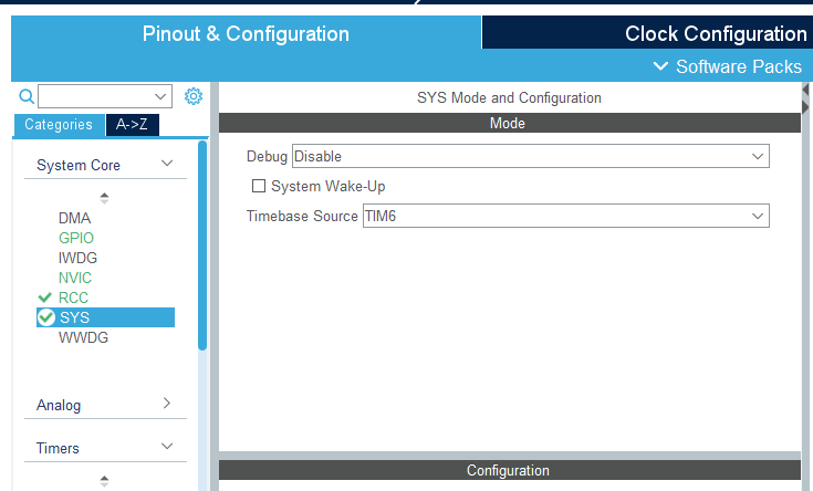

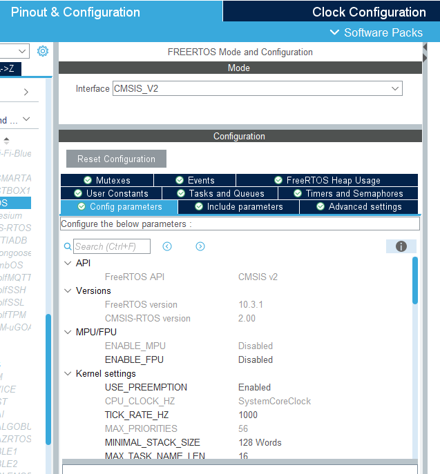

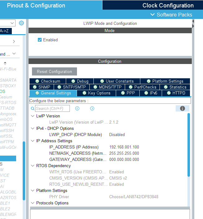

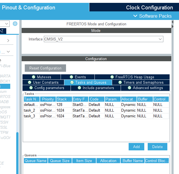

but now I want to use freertos and have a UDp server, but when configuring freertos, stm32f407vet6 gets stuck inside MX_LWIP_Init();, the firmware version for STmf4 is 1.28.1, here is the code:

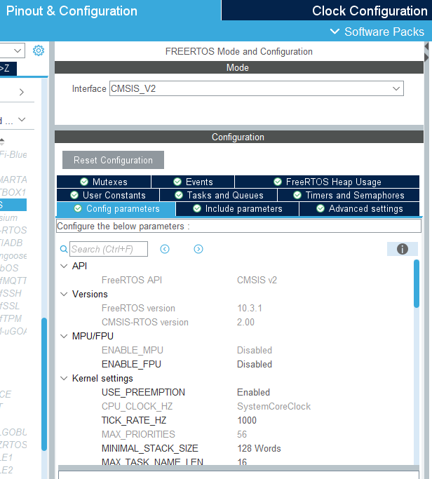

Hello @Mauricio_Vieira,
In your case, the application is stuck during the LwIP initialization due to insufficient stack size. You should increase the stack size to at least 256 words, preferably 512 words.
