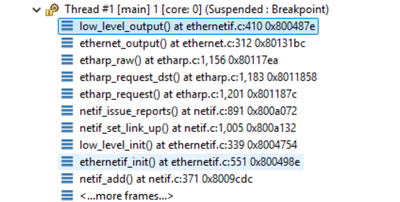

Hi, it is getting stuck in the while loop in low_level_output. Here is my stack trace.
if (HAL_ETH_Transmit_IT(&heth, &TxConfig) == HAL_OK) {
while(osSemaphoreAcquire(TxPktSemaphore, TIME_WAITING_FOR_INPUT)!=osOK)
HAL_ETH_ReleaseTxPacket(&heth);
} else {
pbuf_free(p);
I will look into the LwIP debug info guide now
