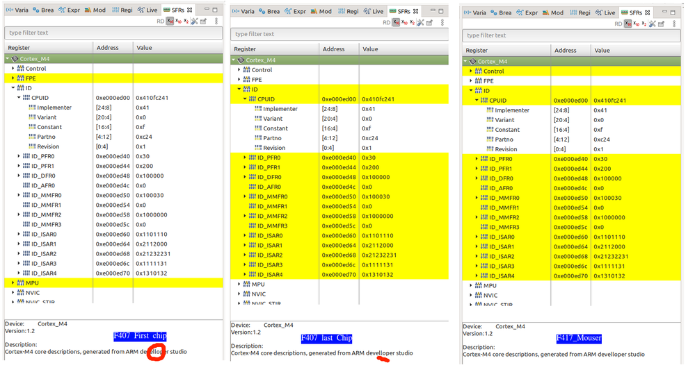

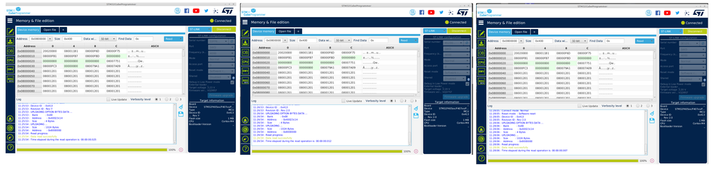

Hello Tesla DeLorean, all other, Yesterday I finally received new F407 chip.
Applied to a new board it work and respond to ping. Now 3 board are complete, F407 With name First doesn't work. F407_Last and F417 work.
Attached are images from CubeIde register and from Cubeprogrammer, all MCU return same ID, just F417 report version Y instead of version 2.0.
Also attached as Zip the text dump of all register by part.
Hardware test:
On board F407_First try'd rework PHY, no success, New PHY still complete negotiation and link but no MAC TX activity.
Don't rework F407 for now I reserve do some Inspection on.
